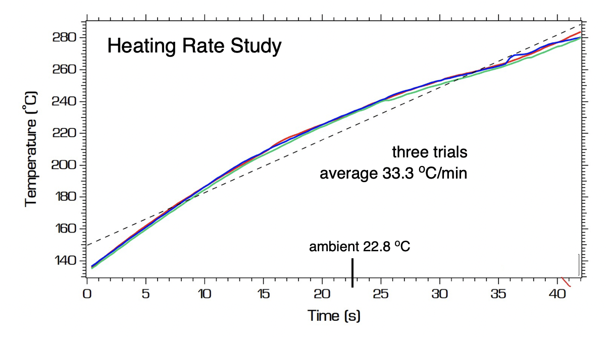

The graph is fairly simple, but I'm under a corporate template for this poster that needs to use all the same font (it's called EuroStyle font).  As far as 3rd party software, I can easily do this to the text in Photoshop, then insert that onto the graph, but I was wondering if there was something easier I was missing in Igor.
Here's a screenshot.
Screenshot 2026-02-11 122214_0.png (107.69 KB)

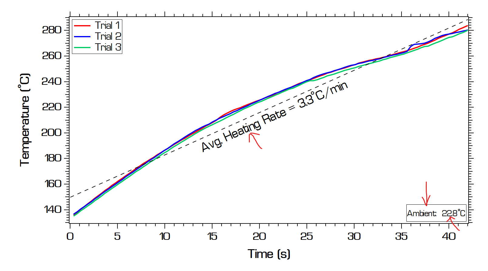

jasonjphillips wrote: but I'm under a corporate template for this poster that needs to use all the same font (it's called EuroStyle font)
My apologies. My lecture on the evils of those making uncharacteristically non-standard font choices is probably better passed to your corporate administration. If you will allow, I attach a recommendation for improving the visual separation of data (the lines), context (the title), and parameters (the other annotations). One recommendation that is not shown -- change the lines to "color safe" colors and/or use different line styles. For example, folks with certain color-blind traits will see three black lines on your graph.
