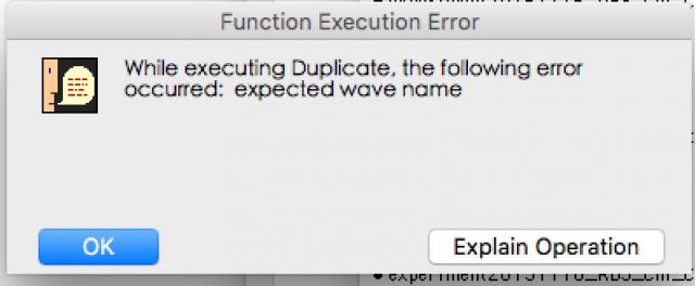

I wrote a procedure to deal with my experiment data.
When running it, the error message "expected wave name" popped up.
I attached the file and error message below.
Could anyone take a look and help me out.

duplicate $thewave, w          //error: expected wave name

Hi Jim,
Thanks for promote reply. I tried again. There's still something not right.
Error message shows:"while executing duplicate, the following error occurred: expected wave name."

Ah, I see: you're passiing wave parameters using local names c1 through c5 and trying to use $str to refer to them.
That's not really something that WAVE w=$str is designed to do.
You can assign WAVE references, though, so something like:
WAVE cw

//Duplicate/O cw/w why?
chi_all[index-1]= RGS_Chi_Cal(r1,cw,670,720)
may be what you need to do.

Thanks. I tried the code below. It does do the magic.
But I am still wondering if there's some way that I don't need to assign the value to "wave reference wave" value one by one.
5 items is fine in this case, but 100 items would kill me.

The only way I see that this works is when c1 ... cN are waves that are only 1 point long or contain exactly the same value. Otherwise, it is entirely confusing. Please tell us what c1 ... cN really are. Are they waves that have only 1 point in them or waves that have the same value in them?
Also, please tell us what the function RBS_Chi_Calc(...) takes as input. As near as I can tell, it must take a wave and three variables.
