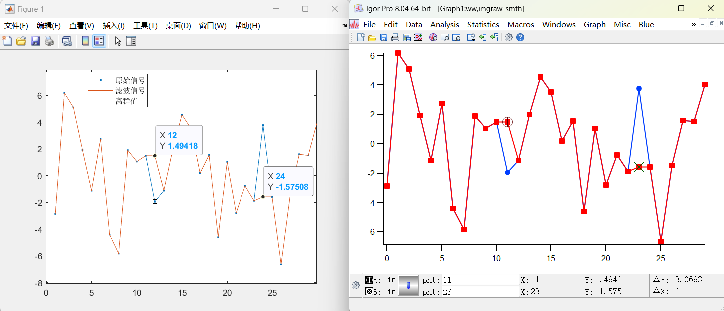

Thank you! I have compared my procedure with Matlab code and found they agree well. I used gnoise in Igor and copy the generated data into Matlab as orginal data and obtained the same filtered data using my Igor procedure and Matlab.
