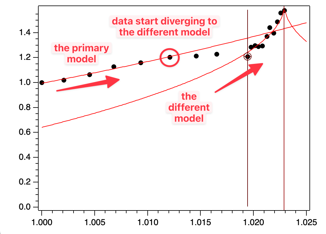

I have an analytical equation that I am fitting to experimental data. The data should fit the model specifically up to a certain point. The data should diverge after that point to a distinctly different analytical model.
The experimental data scatter. They may or may not have uncertainties on each data point.

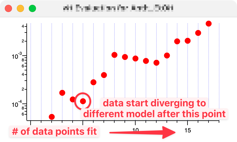

I am seeking a generally accepted way to determine the best point where the data diverge from the analytical equation. My thought is to use an expression G = chi^2/(N - P) (reduced chi^2), where chi^2 is chi-squared, N is the number of data points being fit, and P is the number of fitting parameters being used (2 in this case). I plot G versus N and look for locations where the plot falls and jumps. I chose this approach based on a gathering of information that G should approach unity in a best fit case.
I have applied this approach across a dozen or more data sets with quite good success. See the attached figures for an example. For this set, the data points scatter but were only recorded once (they have no associated y-value uncertainties).
Also, in general, from the majority of my tests so far, I consistently get G << 1 over fitting ranges where I am certain the data is not diverging to the new model. I suspect the result is because I have no weightings for any of the data points.
