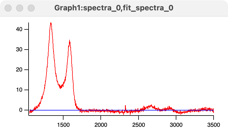

I have tried the MPF2_AutoMPFit() method and while it works, there is one peak that is borderline in intensity that is getting missed sometimes.
I am now looking to explore a FitFunc approach and could use a bit of assistance in crafting the FitFunc correctly.

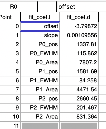

I have three peaks that I want to fit to Lorentzians along with a linear background. I have use the interactive peak fitting on a representative graph to get the fitted wave and the parameters to use as initial guesses.
I have started with this and partitioned the incoming coefficients to three distinct fits.

Now if this worked I would be posting.  I test this on the same data set that I used in the interactive peak fit and it returns a matrix singularity error.  If I try "graph now" in the coef it is showing a flat line.
How do I set this up?

I am working on implementing the fitfunc and I am struggling with the linear offset.  I am plotting the fitted curves and they seem offset by amounts that I cannot account for by the slope of the linear offset.
I notice in the manual that there are warning about fitting  sums of fit functions and the introduction of errors in the linear offsets.
Is there something I should be aware about to help explain the discrepancies I am seeing.
