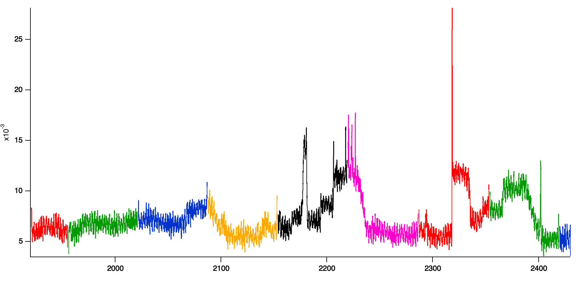

Here is the problem I have a set of waves which are measurements that have been broken up and I want to reconstruct a single wave.  The waves have different  x scaling and there is a break between them were no data was collected.  There are also much higher frequency than I actually need so I can down sample.
I have created a master wave that has x scaling that represents the range of the samples. I found out that I cannot use straight forward x mapping within functions and am forced to use point scaling. It compiles ok, but when I run it I keep getting out of range errors on the last assignment.

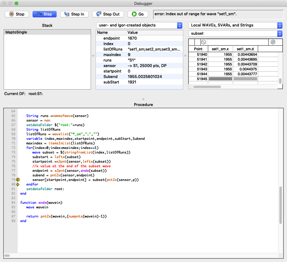

Let me study your code a bit more.  Since the scaling is slightly different with each input wave, I need to keep it constant.  I have set up the receiving wave to have excess span so that is not the issue (I think).  I think the problem is in the pnt2x and x2pnt operations giving rounding errors that can take things out range.  I have added another variable to get a full sense of the span since the p assignment does let me see into the calculations. The real range of the subset wave is 1921 to 1955, notice the conversion process has now set the final endpoint when converted back to the original x scaling at 1955.00256..  This is out the range and causing the failure (I think). Now I have think about how to trap at both ends.
Debugger window (149.48 KB)
hegedus
Made some modifications that trapped for the beginning and ending points of my receiver wave range.  I use a combination of min and max statements to make the range is always within the range of the subset wave.  This works but was way more painful then it needed to be.  I had thought the use of wave scaling would be a benefit, but with great power comes great bugs.
