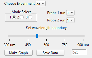

Using the same panel from my previous question: https://www.wavemetrics.com/forum/general/how-poll-all-controls-when-interacting-any-control
I would like the "Probe 1 run" and "Probe 2 run" to update to either "1" or "n/a" depending on if there is data available for those probes. That is, it should default to the first replicate experiment wave if it exists, or display "n/a" and disable if it isn't.

This does not work. This disables or enables the popups just fine, but it does not set the display value. I don't so much care about displaying "n/a" when the popup is disabled, but it's pretty crucial that the popup revert to the first replicate if it exists, since that feeds forward into further processing.
