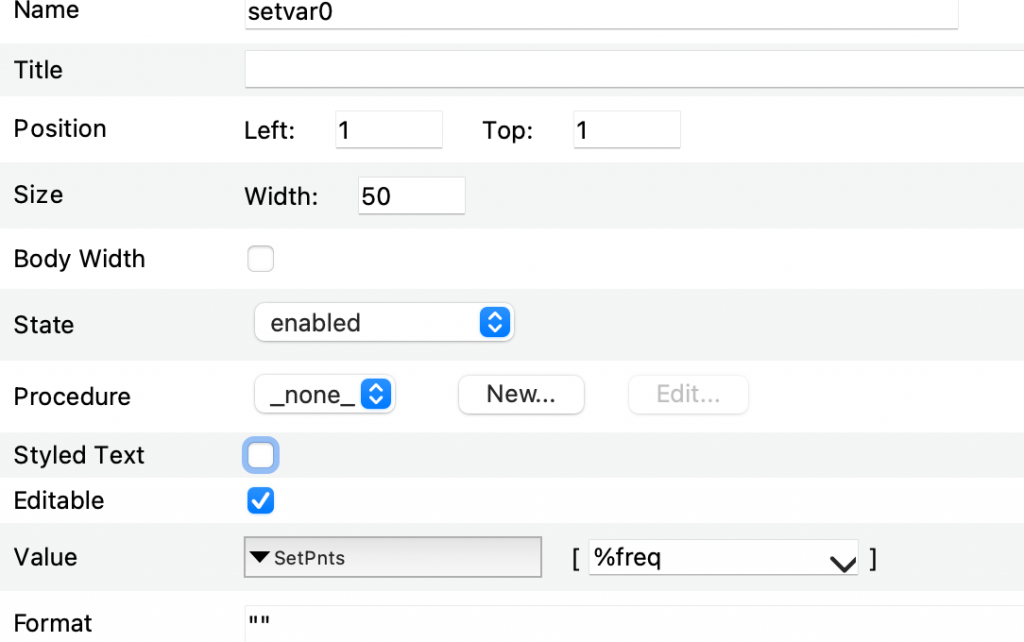

What would be even better would be to tie it to wave point. When designing systems that will evolve over time I often put all the numeric settings into a wave with a dim labels. That way I have one declaration to do in a function and I can easily see the state of the system by looking at that wave in table. Typically I have one wave for numeric states and a second for text. This keeps things very clean with needing global variables. Alas in this case I can't tie the state a wave point. Just part of the wish list.
Andy ... Can you give a minimum working example (MWE in the LaTeX stack exchange)? I am confused by what aspect of the control is being tied to a wave point. Specifically, are you tying each point in the wave to a different control on the panel?
My mistake. What I mean is, can you give an example of how tying the state of a control to a wave point WOULD work. I don't see what you have as a vision for this.
I was thinking the same way you can in set variable control. See the set value line to pick a wave and its specific point.
February 13, 2021 at 11:01 am - Permalink
February 13, 2021 at 12:17 pm - Permalink
In reply to Andy ... Can you give a… by jjweimer
Ji Jeff,
They are NOT tied a wave point, it is on the wish list.
February 13, 2021 at 12:55 pm - Permalink
February 13, 2021 at 01:02 pm - Permalink
Hi Jeff,
