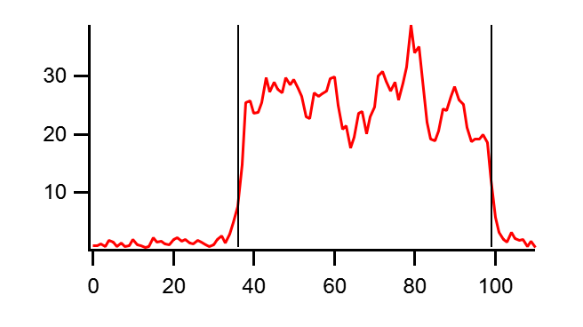

I am trying to track the width of a plateau through time in Igor Pro.
I thought that one could use the differentiation and find the Min and max, signalizing the "start" and "end" point of the plateau.
However, there are many points that have a bigger gradient at some point and is not the plateau border.
Has someone an idea how I could optimize and adapt my idea ?
I thought about setting borders for the WaveStats command to simply search in the first quarter and last quarter, but I did not figure it out.
PS: I used V_min and V_max.

Some questions and thoughts. How is the plateau defined? Is it flat a constant value or somewhat so? Or another definition, is it time above a certain value?
Things I would myself start looking at is using findlevels with a threshold set to a given amplitude. The resulting waves will be the point where the wave crosses that value and if set to a value other than the absolute max, could result in pairs of crossing, first up and then down. With the difference between two points being the plateau time.
If you are looking at "Flatish" behavior, then I might use a derivative and couple it with a logical test to see if the absolute value at that point is above a threshold. Combined it would give you a 1 for in a plateau and 0 for everything else. I would then use findlevels again with a trigger value of 0.5 to see where it transitions.

I presume you are saying that noise in your data causes excessive noise in the derivative, which is not surprising- a numerical derivative amplifies the noise. Sometimes you can smooth the data and take derivatives of the smoothed data. You have to be careful, of course, not to smooth away meaningful features in the data.
We don't have built-in support in the Derivative operation, but it is also possible to use higher-order kernels for computing the derivative. Such higher-order kernels use a wider window to estimate the derivative, which effectively applies some smoothing to the derivative.
Could you post the actual data in the graph so we could play with it?

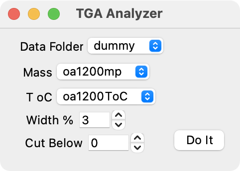

I do derivatives on data that has noise using a slope method. I use an interface as shown below. Here's the code for the two primary calculation functions.

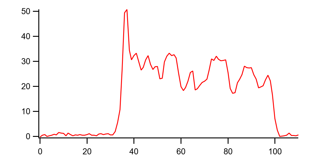

The data in that file doesn't look much like the picture you posted up top. Here is my graph of column 6:
/sites/default/files/2024-09/annalisaIgorExchangeGraph.png
That data looks like it should be pretty easy to handle with Igor's `FindLevel` operation. So I have to ask: where did the picture up top come from? Is the data file you posted representative, or will some data look like your picture?

Here is a bit of code that works well with the data in your file:
The grunt work is done by `FindAnnaLisaPulse()`. It returns a free wave containing the start and end of the pulse in the input wave. To use it, you need to call it from other code.
Use `FindPulseAndGraph()` to make a nice graph showing what was found. It also saves the free wave as a global wave called <name of input wave>_pulse.
September 17, 2024 at 12:10 pm - Permalink
Here is a graph created by my code
September 17, 2024 at 12:12 pm - Permalink

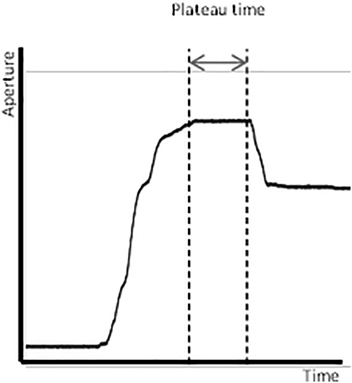

The data in the first picture was from the internet and just for describing purpose. (Thought I pinned the source somewhere, so to be fair- source: https://www.researchgate.net/figure/Representation-of-the-plateau-time-…; )

Just to follow up a bit- the data from the internet has quite a different shape compared to your own data, and would require some quite different heuristic to find the correct places for the start and end of the plateau. When you need help with an algorithm like this, that is dependent on the data details, it's always best to share your own data if you can.
