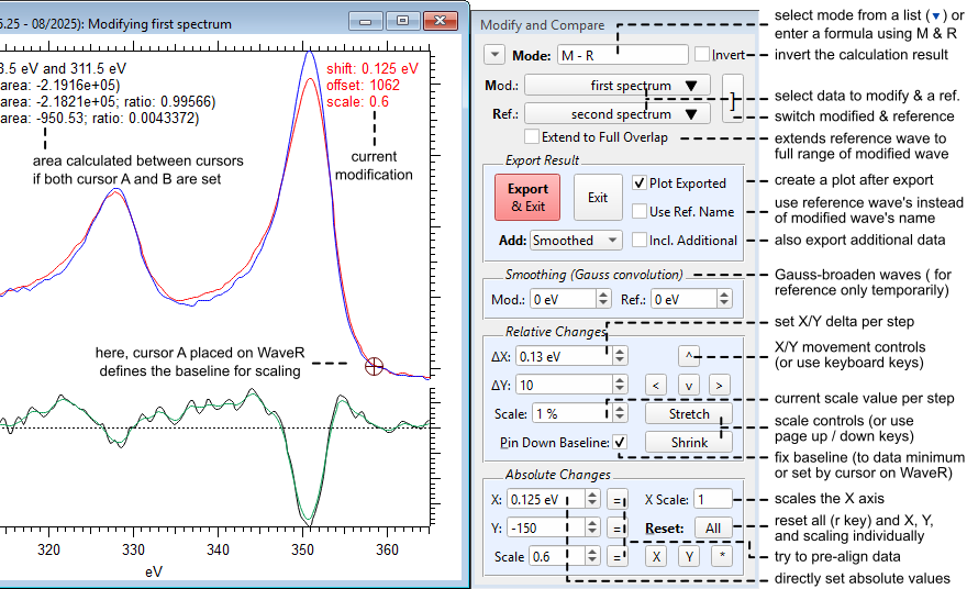

Graphical User Interface (UI) controls - 1D data
Select one or two waves in the Data Browser and then navigate to 'Spectra Tools' → 'Compare and Modify Data....' in the main menu or use the command line:
WaveArithmeticUI(WaveToEdit)
or alternatively:
WaveArithmeticUI(WaveToEdit,refwave=ReferenceWave)
The second wave selected in the Data Browser or provided via the optional 'refwave' parameter is pre-selected as reference. This is an overview of the controls (here, for modifying 1D data):
The modified wave and the reference wave can be selected via the drop-down menu and their role switched via the ] button. If Extend to Full Overlap is active the reference data is extended by repeating the averaged endpoints to the range of the modified data (no effect if the data overlaps already fully). This is most useful when the edge values of the reference are close to zero so that the error is small. This feature is only available for calculations involving 1D data.
Operation Mode:
  • Choose a preset from the (▼) drop-down menu: M - R subtraction (- key), M + R addition (+ key), M * R multiplication (* key) or M / R division (/ key), (M + R) / 2 average or (M - R) / (M + R) * 200 percent difference.
  • Any custom equation may be entered directly using M (modified input data) and R (reference data).
  • The result can be inverted (flipped along the Y or Z axis) with the Invert checkbox (i key).
When you are done:
  • Export & Exit will export the result and modification as separate waves and then closes the UI.
    The exported waves are plotted in a graph when the Plot Exported checkbox is active. All previous graphs with the same data are updated as well to reflect the new settings. All settings are saved with the output and will be reapplied upon reloading. See further below for an explanation how the data is saved including the purpose of the 'Use Ref. Name' setting.
  • Exit will close the UI without saving anything.
  • Use the Add drop-down menu to select the type of post-processing: smoothing, integration or derivation of the result. Activating the Incl. Additional item will export this post-processed data as well (name ending '_smt', '_int' or '_der').
Applying Changes to the Input Data:
  • Shift in X / horizontal and Y / vertical directions using the arrow buttons (cursor keys on the keyboard).
  • Scale using the stretch (page up key) and shrink (page down key) controls.
  • The delta step of each modification can be set using the controls to the left.
  • Absolute Changes in the lower section of the UI can be used to dial in the desired values directly.
  • Pressing the = (equal) button next to each axis value will automatically pre-align or scale the data to match the reference in the respective direction. Hold Option (Mac) / Alt (Win) while pressing ‘=’ next to Scale to scale the data by using the total area instead of the minimum / maximum intensities.
  • Use the Reset buttons for All modifications or individual changes of the X / Y shift or (*) scaling to undo modifications.

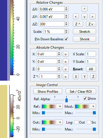

Graphical UI controls - 2D data
2D data is loaded and processed in the same way. The data is now displayed as two overlapping images, with the reference data plotted as a semi-transparent layer on top of the input data. There are additional controls specific to 2D data (see below), such as additional controls to modify the third (Z) dimension:
At the very bottom are additional controls to modify the image appearance:
  • Ref. Alpha: The transparency (alpha value) of the reference data. Choose between fully transparent (slider to the left) and fully visible (slider to the right).
  • Show (reference): Toggles the visibility of the reference image. Uncheck to hide. Can also be toggled with the s key on the keyboard.
  • Image color and Range controls: Choose the color mapping for each image and adjust the displayed z-range via sliders.
  • Log (colors): Switch to log color display for the output (Out) or source input data (Src).
